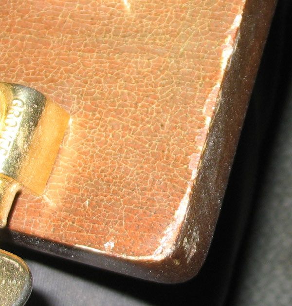

edit: found a photo I'd uploaded last week while discussing this very topic. It's my beater guitar, and the 'antiquing' wasn't done intentionally; it just happens up here when you take you instruments to camps up the river, towed behind snowmobiles at -30 to -40 temps, and then taken fishing in the hot summer sun, then back to the winter camps, season after season...

The one in the photo is Behlen's, which I find crazes much more readily than McFadden's. That was my main reason for switching! I could ship a McFadden-finished guitar in sub-zero temps as long as it was under 6 weeks old. No way Behlen's instrument lacquer would hold up...
